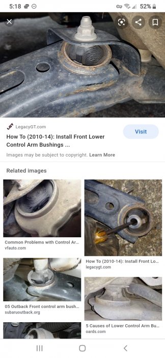

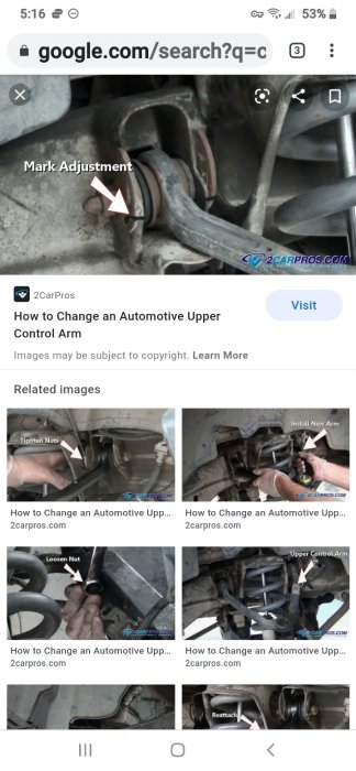

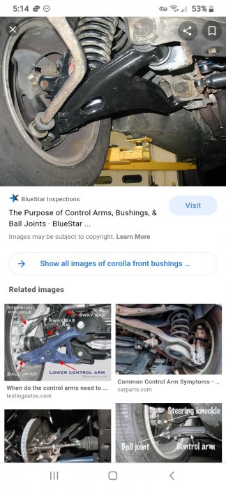

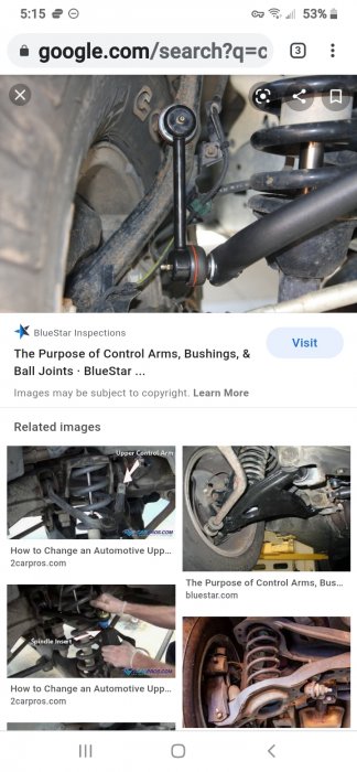

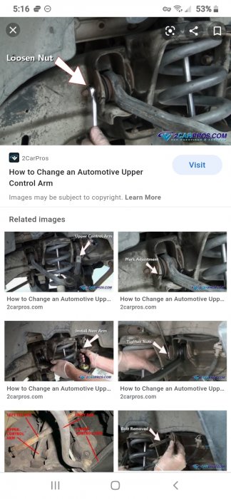

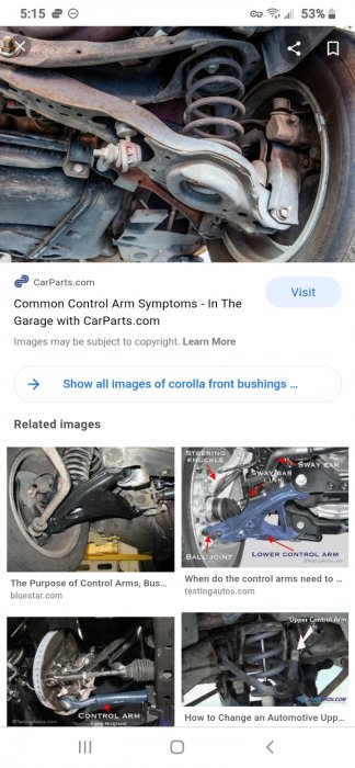

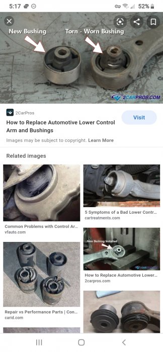

Can you upload pictures of the joints?
Just google corolla front suspension pictuers.
You will get lots of pictuers.
If corolla still squaks in suspension after spraying front end. Dont forget to spray some silicon up the spring ( lower strut housing and on top of strut ( lift hood ) , may be because you have high mileage say 100,000 miles+ .
Then you may need to replace some frt end parts, jiggle them to see if their loose ( bushing may be gone )
If your not qulified to take on the task find & stick with an honest mechanic.
If you find the job to expensive, & depending on overall condition of the vehcle you may want to trade your Corolla for a new one.

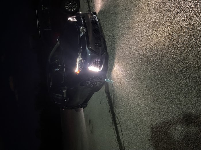

I have a 2017 Corolla SE CVT with just shy of 122k miles, mainly all highway with like 4 months I was doing Uber, no major issues at all. To date I’ve replaced the CVT fluid twice, coolant, tons of oil of course and a front left wheel bearing. I am going to do brakes and spark plugs soon. Great little car even if “car guys” hate the CVT. IMG_2381.jpeg
