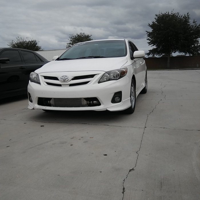

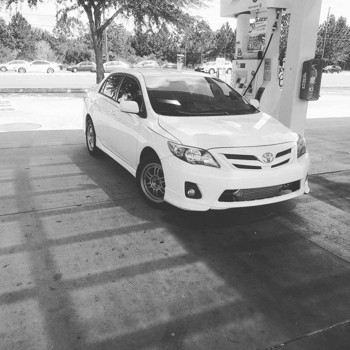

I currently have the 2zrfe turbo kit on my 2011 toyota corolla and i have the 4 speed auto transmission. Now unlike the manual, the auto has aftermarket upgrades (just look up u341e transmission upgrades on google). The company level 10 has an upgraded torque converter, valve body, and clutch packs for the this specific tranny on the 2009-2013 corolla. Im running 10 lbs of boost from a gt2560r turbo into my 2zr-fe with no internal upgrades, just a transmission cooler. From my experience, the transmission still holds but slips a little bit. Expected from an econobox tranny.
nice! Pics please? :D
very nice! any idea how much power it puts out? And how hard was the install? Any problems with it? I would love to turbo or supercharge my 2014 corolla, but it's my daily driver so I can't be without a car for too long haha. I'm also very concerned about the CVT transmission. No idea what it can handle.
Okay lol after watching a ton of your IG vids, I can see that it caused you quite some problems. Of course that's the fun of it, but as my daily driver I can't afford to have too much down time. Would you recommend turboing the car or no? haha
Ok so i just woke up. Mt car makes around 240 whp 230 wtq and it is really fun. I do recommend but i do agree with your worries in that the cvt sounds like it would shatter like glass. The one thing i think about is a transmission cooler but im not sure if it would fit. I dont know too much about the technical terms but i do know this, the transmission cooler is pretty much a rest stop for the fuild in your tranny. To explain it further, the fluid is rerouted into the cooler and back into the tranny, cauing it to be air-cooled. So if your tranny can accept a cooler, i would turbo it. Alot of people have told me to trade in the car for a manual or do a manual swap, but in reality, my 4 speed auto has held up and there are aftermarket parts for it (u341e is the transmission code). I do not have the cvt but all i can say is look up other upgraded cars with cvt trannys, even though its not toyota, it can ease your worries because it will give you a baseline.
