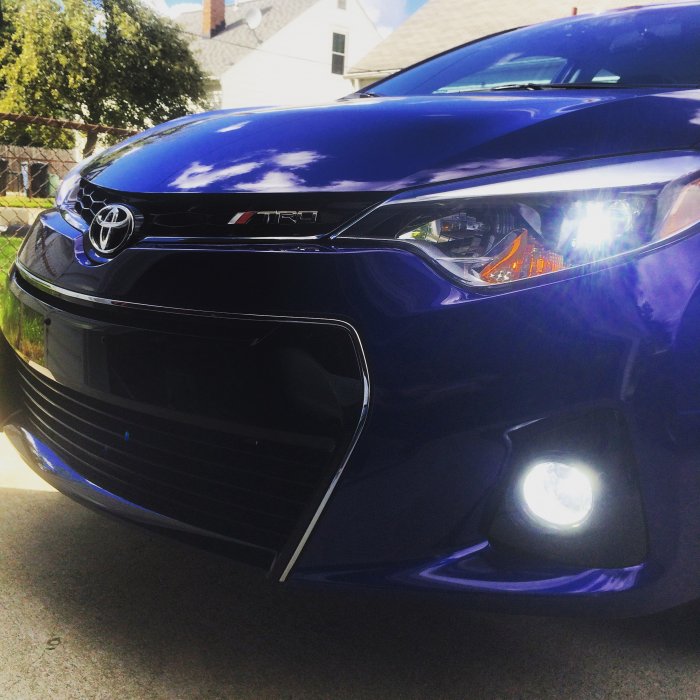

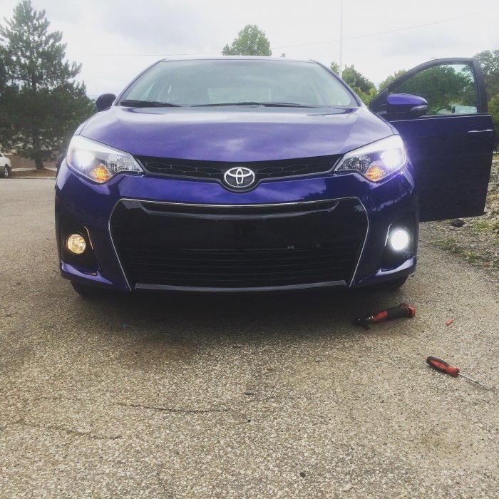

Just got my JDM Astar Fog Light bulbs!! Those things look really well made. The housing is aluminum and connector is sturdy plastic. Sadly my car will be in the shop getting some body work done but I will install them as soon as I have it back..
