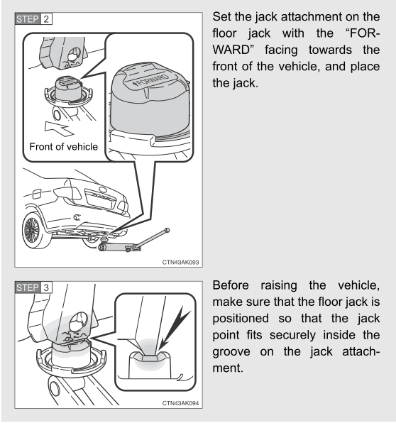

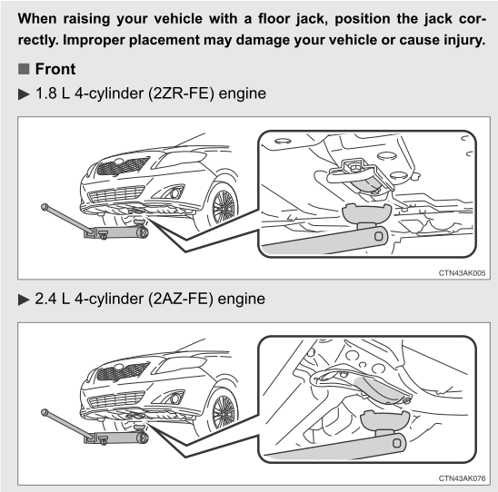

Here's an update to this old thread with pics of the central jack points from my 2009 Corolla OM. I place 4 jackstands at the side lift points for support. Corolla central jack point front.png Corolla central jack point rear.png
