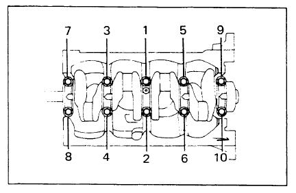

The Haynes manual says 44 Ft Lbs for the 1.6 liter using the torque sequence in the picture. It might be best to divide the 44 Ft. Lbs into 2 passes. The first at 22 Ft. Lbs and the second to 44.
