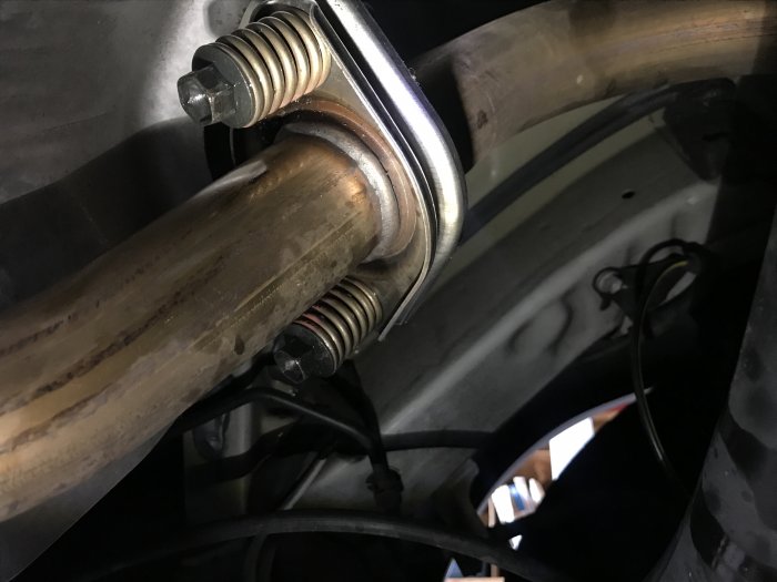

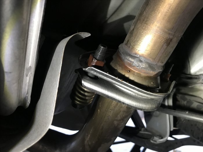

those things are a bitch to remove....i did this one time to get that deep muffler tone and i used anti-cease.... i drowned the bolt in that stuff and it did the trick(just make sure not to get it in the pipe) thats probably your only hope.
Get exhaust hot and they try. Also, look to see if the nut is tack welded. If so then remove the bolt and spring.
Also, your gonna need something with ass. Like a pipe for leverage on the end of your ratchet.
Daril
Use a pipe/tube to use as leverage on your ratchet. That's how I did mine with everything cold. Is hard, but that will help you.
I just did this process the muffler confused me at the axle back I figured out that it was only one Bolt the back of it is a square nut that was welded on to the frame of the exhaust you only have to undo the bolts, went with Borla axleback/cat back with 1 resonator delete under driver n passenger
