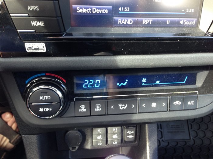

I just bought this 2015 Corolla LE with the Technology Package. Where I live it's already starting to get cold in the mornings so I need the heat on. On my wife's Honda, when you set the thermostat (and I am assuming that what I have here is a thermostat) for 22 you are toasty warm and the air coming out of the vents is hot. With this Toyota the air from the vents is barely above the ambient temperature which is pretty cool at 7AM. Cranking it up to the max level of 32 does do the trick but even then the air from the vents isn't nearly as hot as what we get from the Honda when it's set to the max warm setting. This isn't much of a problem now but I'm worried that in the winter when we get a lot of -30C days the car will be an icebox. I'm curious to know whether any of my other Corolla LE compatriots find the heating in their cars inadequate. By the way, why would the thermostat setting even go as high as 32C since this is a ridiculously hot setting that everyone would find intolerable?

I always leave mine at 22° on "Auto!" (which, by the way, doesn't seem to be "on" on the picture). For a couple of minutes, it kind of restrain itself until the car is hotter or the AC cooler than blow at full speed for a period depending on the outside temperature then slow.

" I always leave mine at 22° on "Auto!" (which, by the way, doesn't seem to be "on" on the picture). "
I am shocked - the Auto system is On in the picture as far as I know - why would you say it's not? Thanks for those very good explanations Brewcaptain and Jolly - they were very helpful.
Might be the picture : I don't see the green light above the "Auto button" while I see those, albeit faded, above "recirc" and AC. Also it might be a reflection but the "rear defroster" seems "on" to.
Picture shows system NOT in Auto mode Plus the fan speed(which must be selected by rotating knob)
since not in Auto mode shows very slow fan speed selected. So regardless of the temp setting the warmup
will be slow since fan speed in low.selection. Press the Auto button and you'll be fine.
As what everyone else said, you aren't in Auto
When Auto is off, the temperature readout is more or less decoration than an actual setting (like the blue and red gradients on manual systems).
