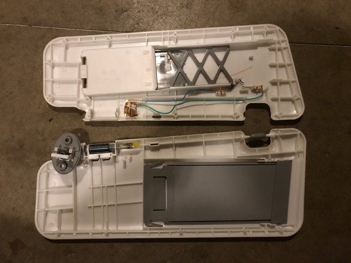

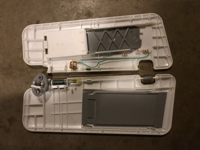

Ever wonder what's inside your sun visor?
Now I know why they are so expensive.
No, this isn't a Corolla sun visor. But it is a Toyota sun visor.
This came out of my 08 Highlander. It wouldn't close all the way, so I've ordered a new one.
I never realized how much was going on in there.
I had to cut off the vinyl wrapping in order to figure out how it comes apart, or better yet, how it was originally assembled.
Reverse engineering at it's best! Lol

The vinyl was tucked in at the mirror, so if you could get the mirror out without breaking it, that would be a good place to start. Just remember that they only sell the visors as a unit.
If you zoom in on the top picture, you can see two tabs where the mirror part locks in place. The other side of the mirror just kinda hooks in, not a tab type connection.
