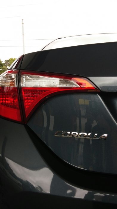

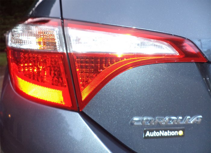

heat it up with a hair dryer to loosen the adhesive.....use strong fishing wire to slip under the badge and use a back and fourth sawing motion.....and I'm sure it will be left with some residue.....GET GOO GONE!!! they sell it on amazon and it works wonders, i personally use it and have use it on my corolla to remove stickers...put a squirt let it sit and use some elbow grease....
