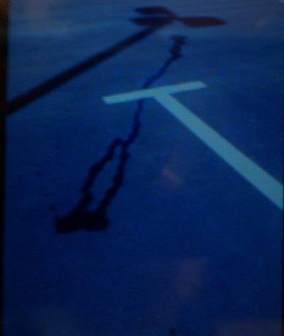

Yesterday, for the first time I drove it for a few hours (total distance cca 400 km). Outside temp was about 30C and I turned ON the A/C. After finishing driving, after cca 30 mins. I noticed a water below the car (I think it was water). Naturally I thought that this is condensate from A/C, but it was strange that dripping was present even after half an hour after I turned off the engine. Drops intervals were cca 5 sec. I didn't have similar experience before and don't know if this is normal. My friend that is long time driver told me that it is normal dripping to last up to 10 mins after but not 30 mins.
Also, it is very hard to estimate the amount of liquied (water) on the parking lot (0.2 l can sometimes look like flood).

It's normal, and how long water drips out depends on several factors.
Water dripping out of the HVAC isn't going to harm anything, even if it seems like a lot.
Now ... if the water dripping out of the HVAC looks like coolant, and your coolant levels are falling, then you have a leaking heater core.
